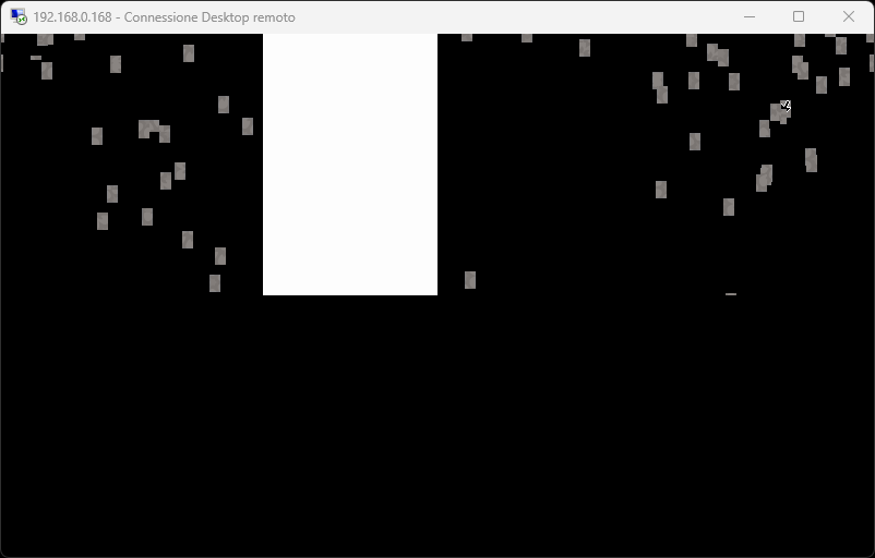

I'm testing an iMX93 based SOM running Yocto Kirkstone - Linux v5.15.71_2.2.0.
I've compiled myself a full image including XWayland and Qt 6 (fsl-image-qt6).
Weston seems to work well, but I am unable to share the screen via the RDP backend. When I activate screen sharing, I can connect to the board via Windows RDP client, but all I get is a scrambled, mostly black image:
Furthermore, the cursor in the main screen is moving very slowly.
Is there any way to make this work on iMX93?

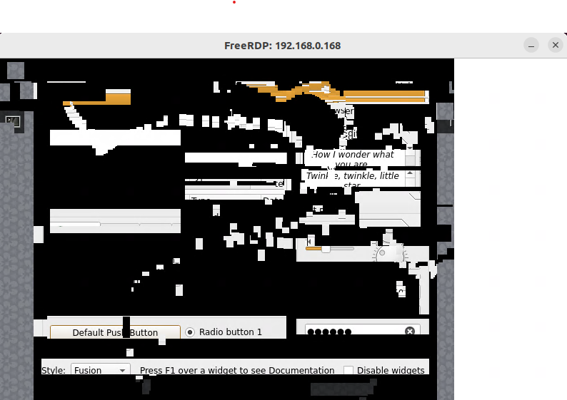

I've finally managed to test Weston's RDP backend on the latest BSP (Yocto Langdale, Linux 6.1.1, Weston 11.0.1), but the result is the same:
NOTE: in order to be able to test this, I had to:
  • enable the building of the RDP backend in "weston_11.0.1.imx.bb" (see attachment "weston-enable-RDP-backend.patch")
  • enable the building of the server library in "freerdp_2.8.1.bb" (see attachment "freerdp-build-server-library.patch")
Any suggestion is highly appreciated
