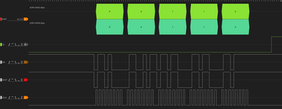

Hi NXP team,
I have created the node and pin settings for the spi3 in dts but I am unable the see the spidev_test data tx/rx as shown in the logs  I have connected the MOSI and MISO pins also for loopback but no rx data I am getting pls check :

Hello @sbmd_1234
I hope you are doing very well.
Please refer to the imx93-11x11-evk-lpspi.dts.
Then, you should be able to get it working:
Without connection between SIN and SOUT:
With connection between SIN and SOUT:
FYI: tested on imx93evk and 6.6.23 bsp
Salas.
