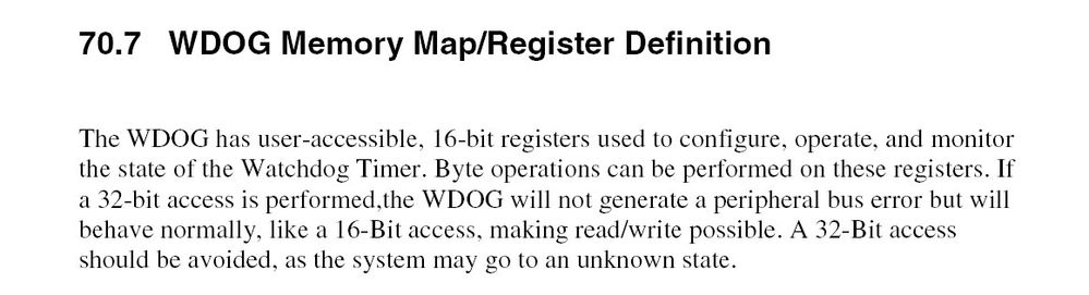

igorpadykov
Hi Andrew
one can check if access to wdog is 16 bit, refer to part of RM
then one can test with wdog test, included in imx-test package (like imx-test-3.0.35-4.1.0/test/wdog)

andrewparlane
Hi Igor,
Yes I saw that, and checked. The linux driver uses __raw_writew() which turns into (*(volatile unsigned short *)(a) = (v))
So should be 16 bit access. Plus my dump, reads back and hence verifies the values. The extra leading 0s in my output trace is because I used %08X in my printk().
