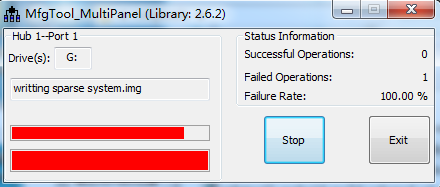

Using MFG TOOLS with i.MX6SXSD,something wrong with it

log:

UTP: received command '$ simg2img $FILE /dev/mmcblk3p5'
UTP: executing "simg2img $FILE /dev/mmcblk3p5"
Failed to read sparse file
UTP: sending Non-success to kernel for command $ simg2img $FILE /dev/mmcblk3p5.
utp_poll: exit with status 65280

bowenzhang
I used demo image.Now,I have make it.because  mfg's version is wrong.thx

brunochen
I have the same problem.
How do you know you use the wrong mfg version?
BTW, could you share how to find the correct mfg tool?
Bruno
2,209件の閲覧回数
bowenzhang
