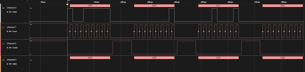

I am having trouble using the ECSPI from the Cortex-M4 of the i.MX8MM with the functions available in fsl_ecspi.c.
Eventually, I need to communicate with complex ADC and DAC devices.  To try and simplify things to prove the interface I have gone back to an SPI flash device and trying to read the manufacturer ID.  The flash data sheet shows the following diagram:
Screenshot 2023-05-25 at 14.05.00.pngScreenshot 2023-05-25 at 14.05.00.pngLooking at the SPI bus on a logic analyser I don't ever seem to see any data coming from the device.  I appear to have 4 bytes being written to the slave device and the CS# going high then low between each byte being sent.
The setup of the ESCPI controller is as per the SDK sample:

Thank you for sharing more information, from the piece of code you have shared and the analyzer image, it seems that the output you're seeing after 0x9f are random stuff because you have set a datasize of 4.
masterXfer.dataSize = 4;
Since only the first byte have a value the other 3 bytes will be dummy data, and you could see this in the ecspi driver located at: SDK_2_11_0_EVK-MIMX8MM\devices\MIMX8MM6\drivers\fsl_ecspi.c

Also, if you need the SS to stay active, you'll need to have SS_CTL clear and after looking into the driver code this is not supported, but that does not mean it could not be added on your side, you may refer to the reference manual for more information on this:

The output on the logic analyser shows:
I'm seeing 4 bytes being sent on MOSI (the top trace) which is the correct 0x9f byte followed by three random values, nothing ever on MISO and the slave select / enable pin (channel 2) is transitioning high then low again after every byte sent.
What I am expecting is the 0x9f being sent on MOSI, three bytes 0x1f, 0x45, and 0x01 being received on MISO and the enable pin to stay low the whole transfer.

Can I just confirm that in order to keep the SS signal active I need to set the SS_CTL bit to be 0?
Looking at the Reference Manual and the source code for ECSPI_MasterInit() then it looks like currently that bit is being ignored as the SMC bit in ECSPI_CONREG is set to 1.
I'm guessing that means that I need to modify ECSPI_MasterInit() to make the SMC bit configurable and if SMC bit is cleared then the transfers need to be initiated by setting the XCH bit.

Apologies for re-opening this but I have made all of the changes that I anticipated to the ECSPI functions in the SDK but I cannot get the SPI interface to work.
When I try to initiate the transfer, I am never seeing the slave select signal go low.  I have added some debug to ECSPI_MasterTransferBlocking() to look at the contents of the SPI registers and they appear correct.

I do not understand clearly which part is not responding, I believe it is the slave right?
I think it would be better to try an ECSPI example, i.e. b2b_transfer so you could see the SPI bus with you analyzer.

I never did manage to get this to work properly using the chip select pin (SS0) configured as part of the ECSPI interface.
To work around it, I configure the pin as a GPIO:
gpio_pin_config_t xGpioConfig = { kGPIO_DigitalOutput, 1, kGPIO_NoIntmode };
IOMUXC_SetPinMux(IOMUXC_ECSPI1_MISO_ECSPI1_MISO, 0U);
IOMUXC_SetPinConfig(IOMUXC_ECSPI1_MISO_ECSPI1_MISO,
                    IOMUXC_SW_PAD_CTL_PAD_DSE(6U) |
                    IOMUXC_SW_PAD_CTL_PAD_HYS_MASK);
IOMUXC_SetPinMux(IOMUXC_ECSPI1_MOSI_ECSPI1_MOSI, 0U);
IOMUXC_SetPinConfig(IOMUXC_ECSPI1_MOSI_ECSPI1_MOSI,
IOMUXC_SetPinMux(IOMUXC_ECSPI1_SCLK_ECSPI1_SCLK, 0U);
IOMUXC_SetPinConfig(IOMUXC_ECSPI1_SCLK_ECSPI1_SCLK,
                    IOMUXC_SW_PAD_CTL_PAD_HYS_MASK |
                    IOMUXC_SW_PAD_CTL_PAD_PE_MASK);
IOMUXC_SetPinMux(IOMUXC_ECSPI1_SS0_GPIO5_IO09, 0U);
GPIO_PinInit(GPIO3, 19, &xGpioConfig);
I have then written a wrapper function to handle the SPI transfer which in effect does the following:
Set CS_GPIO low
Call ECSPI_MasterTransferBlocking() for the write part of the SPI transaction with a null rxData buffer
If needed, call ECSPI_MasterTransferBlocking() for the read part of the SPI transaction with a null txData buffer
Set CS_GPIO high
