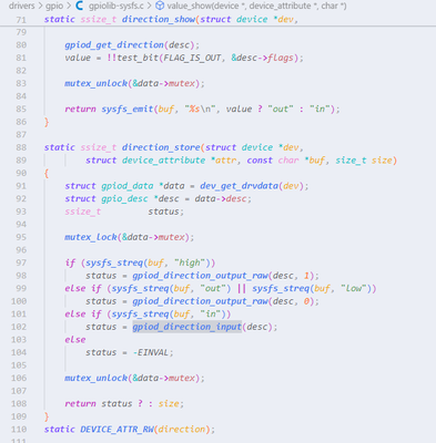

I think maybe you miss some code in your driver, you can refer the sysfs code, have you add mutex during your operation?
