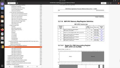

Hello Guys,
I need to read the following MIPI D PHY Register value.
I do not find any offset of these registers in the software source.
Can you please help me out with this problem?
Thank you

Hello @joanxie ,
I need to read the MIPI_DPHY memory map register value (section 13.7.10 in i.MX 8M Nano Application Processor Ref. Manual Rev. 1, 11/2020)which is 64bits in width.
  • Master PLL PMS Value setting Register
    (MIPI_DPHY_M_PLLPMS)
  • Master PLL Control Register (MIPI_DPHY_M_PLLCTL)
  • Master and Slave DPHY Control Register
    (MIPI_DPHY_B_DPHYCTL)
    (MIPI_DPHY_M_DPHYCTL)
    (MIPI_DPHY_S_DPHYCTL)
can you please tell me which of the above registers are located in which offset of the memory map?
Thank you in advance.

joanxie
current bsp doesn't use these registers, and you can check the latest i.mx8mp reference manual, which remove these registers already, imx8mn should be updated in the newer reference manual, so I couldn't tell the address of these registers
