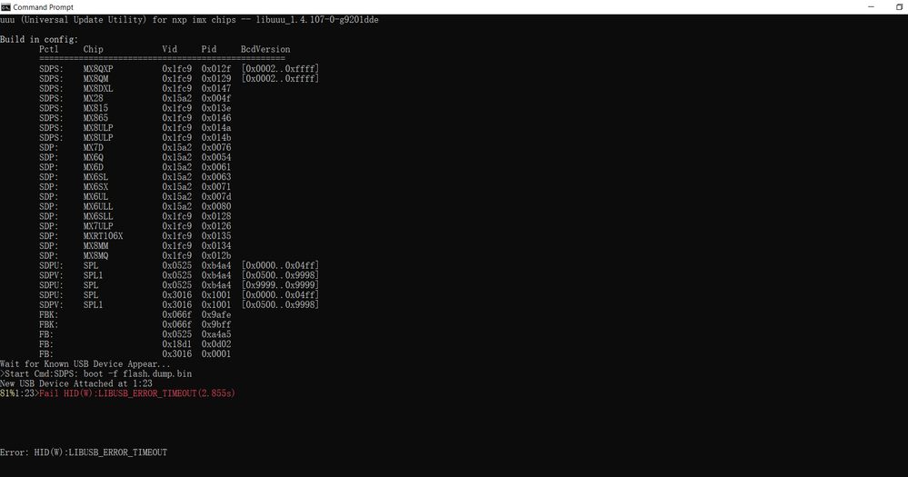

If you don't mind a very ugly workaround, here you can try.
dd if=custom.12.7.img of=flash.dump.bin skip=32 bs=1k count=4096
1. uuu -v SDPS: boot -f flash.dump.bin
you will get an error, but igore it. It is because, the bootloard dump from sdcard mirror, the size mismatch the size information in the boot header.
2. uuu -v -b emmc_all flash.dump.bin custom.12.7.img

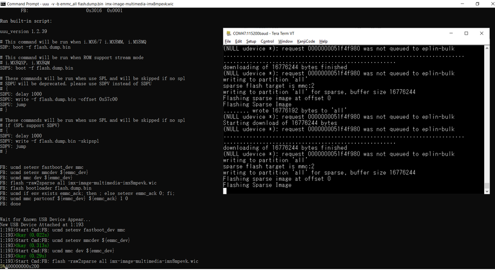

Here is test screenshot for i.MX8MP EVK binary demo image.
imx-image-multimedia-imx8mpevk.wic is the sdcard mirror. Just like custom.12.7.img
dd if=imx-image-multimedia-imx8mpevk.wic of=flash.dump.bin skip=32 bs=1k count=4096
uuu -v -b emmc_all flash.dump.bin imx-image-multimedia-imx8mpevk.wic

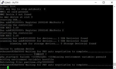

Mohan_SK
Hi Isreal,
Appreciate your support. I tried out the workaround and I could write into the emmc now. But the device is not yet booting. Below is the snapshot of the serial console for your reference.
The boot switch is set to boot from emmc and uboot setenv variables are also set. Let me know if I am missing something
-Mohan
