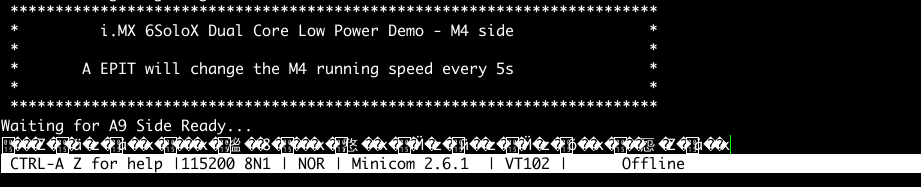

hi,
    i run FreeRTOS on cortex-M4 and linux on cortex-A9,when i run demo app <FreeRTOS_BSP_1.0.0_iMX6SX/examples/imx6sx_sdb_m4/demo_apps/low_power_imx6sx/periodic_wfi_qspi> and cortex-M4 uart garbled after linux startup,it seems that uart clock is change,what can i do?

Hi cai bai,
Sometimes there are problems in clock sync when A9 starts. Run your system and stop the bootloader, then apply the following commands and run your application.
env default -a
setenv fdt_file imx6sx-sdb-m4.dtb
setenv bootcmd "run m4boot;${bootcmd}"
setenv mmcargs "${mmcargs} uart_from_osc"
saveenv
Please let me know if it works.

caibai
it work now ,thank you very much
