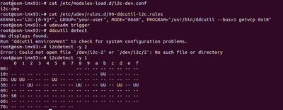

I am trying to test ddcutil on imx93 platform facing no display found issue.
The IMX93, the HDMI output is routed through a MIPI-DSI to HDMI bridge (ADV7535),
On your i.MX93 + ADV7535 setup:
The SoC talks to the ADV7535 via I²C1
We checked the sysfs entry for i2c-dev under
/sys/class/drm/card0-HDMI/ddc/i2c-dev/
and found that no I²C entry was created.
We couldn't find any patch or support for ddcutil with ADV7535
please share you  suggestion MIPI-DSI to HDMI bridge (ADV7535) with ddcutil
root@osm-imx93:~# ddcutil detect
No displays found.
Could you please advise on how to resolve this issue? I have confirmed that DDC/CI is enabled on the monitor.
we have set the udev rules
https://blog.tcharles.fr/ddc-ci-screen-control-on-linux/
The HDMI is working fine ,but the error shows only while running ddcutil detect
