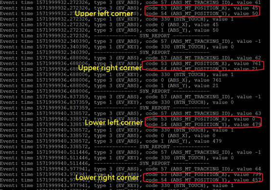

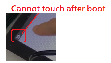

Hello everyone, I have touch driver problem need your help,
I use i.MX6Q with Yocto.
I have changed the new panel, the display is shown normally, but cannot touch(Please see the picture at bottom),
I have checked the DTS & GPIO are normally, the evtest is normally too(reporting the X-Y axis correctly),
I also check the following command and all of them are normally,
could anyone can help me to solve this issue?

Hi Chen
may be useful to check boundary devices touchscreen resources :
https://boundarydevices.com/tag/touch-screen/
Sabrelite: New FT5x06 touch screen and swapped Y (input_set_abs_params)
igor

chenhungwei
Hi igorpadykov,
          Nice to receive your response, do you think this issue is caused by touch driver?
2,486 Views
igorpadykov
yes I believe it may be caused by driver.
igor
