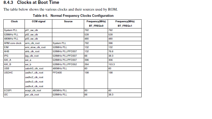

Greetings,
I have  board  based on i.MX6 and configured  with PARALLEL NOR  (EIM) as the boot device.
XTALOSC =24 MHZ and the data width of NOR is 16.
As per RM  below are the cloks at  boot time.
My question is ,
After the  power good signal, how much time does it take to run the first instruction of a secondary boot loader (considering BT_FREQ=0)?
XTALOSC =24 MHZ, System PLL = 792
NOR  DATA Width = 16.
NOR  ADDR Width = 25.
Thanks for your heads up.

Hi Krishnan
please look below
ROM Code Boot Time Measurements
