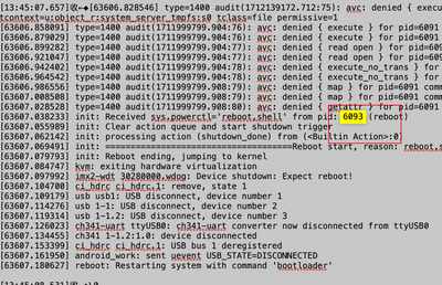

[19:37:36.804]收←◆[ 304.573104] init: Received sys.powerctl='reboot,shell' from pid: 3921 (reboot)
[ 304.580610] init: Clear action queue and start shutdown trigger
[ 304.586875] init: processing action (shutdown_done) from (<Builtin Action>:0)
[ 304.594130] init: =====================================Reboot start, reason: reboot,shell, rebootTarget: shell
[ 304.604415] init: Reboot ending, jumping to kernel

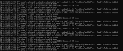

Logcat logs before restart:
04-02 01:36:06.475 I/chatty ( 3064): uid=1000(system) [email protected] identical 4 lines
04-02 01:36:16.888 E//vendor/bin/hw/[email protected]( 3064): /sys/block/mmcblk0/stat: ReadFileToString failed.
04-02 01:36:46.132 I/system_server( 3219): Background concurrent copying GC freed 189893(7MB) AllocSpace objects, 0(0B) LOS objects, 42% free, 9MB/16MB, paused 324us total 122.475ms
04-02 01:37:06.475 E//vendor/bin/hw/[email protected]( 3064): /sys/block/mmcblk0/stat: ReadFileToString failed.
04-02 01:37:16.889 E/storaged( 3106): getDiskStats failed with result NOT_SUPPORTED and size 0
04-02 01:38:16.890 E/storaged( 3106): getDiskStats failed with result NOT_SUPPORTED and size 0
04-02 01:39:16.891 E/storaged( 3106): getDiskStats failed with result NOT_SUPPORTED and size 0
04-02 01:39:06.476 I/chatty ( 3064): uid=1000(system) [email protected] identical 4 lines
04-02 01:39:16.891 E//vendor/bin/hw/[email protected]( 3064): /sys/block/mmcblk0/stat: ReadFileToString failed.
04-02 01:39:52.543 I/system_server( 3219): Background concurrent copying GC freed 189113(6MB) AllocSpace objects, 0(0B) LOS objects, 42% free, 9MB/16MB, paused 266us total 120.259ms
04-02 01:40:06.475 E//vendor/bin/hw/[email protected]( 3064): /sys/block/mmcblk0/stat: ReadFileToString failed.
04-02 01:40:16.892 E/storaged( 3106): getDiskStats failed with result NOT_SUPPORTED and size 0
04-02 01:41:16.893 E/storaged( 3106): getDiskStats failed with result NOT_SUPPORTED and size 0
04-02 01:42:16.894 E/storaged( 3106): getDiskStats failed with result NOT_SUPPORTED and size 0
04-02 01:42:06.475 I/chatty ( 3064): uid=1000(system) [email protected] identical 4 lines
04-02 01:42:16.894 E//vendor/bin/hw/[email protected]( 3064): /sys/block/mmcblk0/stat: ReadFileToString failed.
04-02 01:42:38.871 I/system_server( 3219): Background concurrent copying GC freed 185645(7MB) AllocSpace objects, 0(0B) LOS objects, 42% free, 9MB/16MB, paused 381us total 126.322ms
04-02 01:43:06.475 E//vendor/bin/hw/[email protected]( 3064): /sys/block/mmcblk0/stat: ReadFileToString failed.
04-02 01:43:16.895 E/storaged( 3106): getDiskStats failed with result NOT_SUPPORTED and size 0
04-02 01:43:16.895 E//vendor/bin/hw/[email protected]( 3064): /sys/block/mmcblk0/stat: ReadFileToString failed.

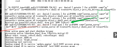

04-02 01:58:47.716 I/system_server( 4789): type=1400 audit(0.0:76): avc: denied { execute } for name="sh" dev="dm-0" ino=2396 scontext=u:r:system_server:s0 tcontext=u:object_r:shell_exec:s0 tclass=file permissive=1
04-02 01:58:47.716 I/system_server( 4789): type=1400 audit(0.0:77): avc: denied { read open } for path="/system/bin/sh" dev="dm-0" ino=2396 scontext=u:r:system_server:s0 tcontext=u:object_r:shell_exec:s0 tclass=file permissive=1
04-02 01:58:47.716 I/system_server( 4789): type=1400 audit(0.0:78): avc: denied { execute_no_trans } for path="/system/bin/sh" dev="dm-0" ino=2396 scontext=u:r:system_server:s0 tcontext=u:object_r:shell_exec:s0 tclass=file permissive=1
04-02 01:58:47.716 I/sh ( 4789): type=1400 audit(0.0:79): avc: denied { map } for path="/system/bin/sh" dev="dm-0" ino=2396 scontext=u:r:system_server:s0 tcontext=u:object_r:shell_exec:s0 tclass=file permissive=1
04-02 01:58:47.716 I/sh ( 4789): type=1400 audit(0.0:80): avc: denied { getattr } for path="/system/bin/sh" dev="dm-0" ino=2396 scontext=u:r:system_server:s0 tcontext=u:object_r:shell_exec:s0 tclass=file permissive=1
04-02 01:58:47.772 I/sh ( 4791): type=1400 audit(0.0:81): avc: denied { execute_no_trans } for path="/system/bin/reboot" dev="dm-0" ino=2415 scontext=u:r:system_server:s0 tcontext=u:object_r:system_file:s0 tclass=file permissive=1

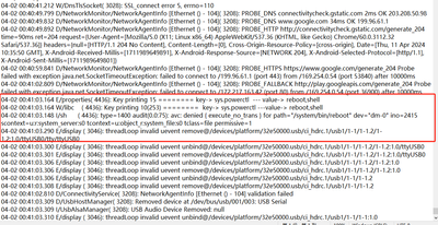

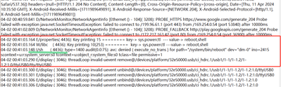

@Only_聆听
update_engine 在触发reboot指令,你搜一下reboot,shell, 后面有对应的pid,也就是谁发出reboot指令的。log里好像不止是update_engine。
29,445 Views
Only_聆听
您所说的update_engine导致的重启是正常的,因为我们为了验证问题进行了OTA升级。目前我们遇到的问题是下面的log,他指向系统服务,但是这个服务挂载了很多的内容,我现在不太懂如何进一步进行排查了,望指教!
[02:40:58.261]收←◆[12605.640916] healthd: battery l=85 v=3 t=35.0 h=2 st=2 c=400 fc=4000000 cc=32 chg=a
[02:41:58.021]收←◆[12665.404888] healthd: battery l=85 v=3 t=35.0 h=2 st=2 c=400 fc=4000000 cc=32 chg=a

系统起来之后,等一会儿把所有的pid信息都dump出来,然后等它crash(这一步可能会找到是哪个脚本),你多测试几遍。
从log看触发reboot的文件位于/dm-0下面,node编号2415。可能和这个错有关:/sys/block/mmcblk0/stat: ReadFileToString failed

您好,我们实际上排查过PID,最终是指向了系统服务,但是系统服务上挂载了很多的内容,如下图,图中圈住的两个服务是我们的软件,但是我们排除我们软件编译后,仍然复现了重启。
然后我们增加了打印,发现是这个函数调用的重启,但是我们围绕这个函数增加了很多的打印,但是其它的打印未打出来。
复现问题时候的打印
我们增加打印的位置如附件,望指导下!

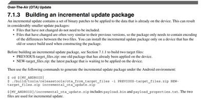

Zhiming_Liu
Hi @Only_聆听
你们的差分包差异大吗?
18,919 Views
Only_聆听
Hi 刘工:
      我是使用make otapackage -j100进行编译的,这应该是全包,或者我应该如何确认是不是差分包咧。
18,898 Views
Zhiming_Liu
你试试差分OTA会不会有这个问题。或者全包OTA只改一个文件。
18,786 Views

您好,我再总结和更新下这个问题的现象:
1、我们的产品从21年5月左右开始对开售卖,但是在2024年的3-4月,大量已经运行了1-3年的机器出现无限重启和被复位的情况。而且问题发生在全球不同的国家。   机器发生问题的时候,很多机器都集中在同一天,例如3月6日、4-1日。
2、我们能获取到的异常机器,debug日志都显示系统服务调用了重启进程;
3、机器无限重启的间隔是1分25S,我们在40S左右就可以使用ADB,此时通过ADB命令date 040123592024.00重新设定任意系统时间,无限重启会立即暂停。但是设定时间后,静置老化仍然有可能会复现无限重启的现象。
4、我们原来以为通过USB烧录的机器不会存在问题,是升级了OTA包导致的问题,但是4-23日,客户端使用USB烧录的机器也出现了问题,证明升级OTA包只是加速了问题复现,并不是问题终因。
5、我们能否获得NXP的高效支持,论坛里面解决问题太慢了,我们可以去现场或者技术支持到我们这里。
6、我们做了很多的努力,尝试通过sys.powerctl 、property_set等关键词增加流程打印,但是收获甚微,追踪到__system_property_set和property_set函数后,就没能找到更往前的调用了,涉及到这些函数调用的函数都增加了打印,但是打印并没有打出来。
7、所有的异常机器重启前的debug串口日志如下:
[00:25:40.016]收←◆[25486.593580] type=1400 audit(1713754045.964:74): avc: denied { execute } for pid=3730 comm=4A69742074687265616420706F6F6C path=2F6465762F6173686D656D2F64616C76696B2D6A69742D636F64652D6361636865202864656C6574656429 dev="tmpfs" ino=26957 scontext=u:r:system_server:s0 tcontext=u:object_r:system_server_tmpfs:s0 tclass=file permissive=1
[25486.623585] type=1400 audit(1711993463.968:75): avc: denied { execute } for pid=4855 comm="system_server" name="sh" dev="dm-0" ino=2396 scontext=u:r:system_server:s0 tcontext=u:object_r:shell_exec:s0 tclass=file permissive=1
[25486.644680] type=1400 audit(1711993463.968:75): avc: denied { execute } for pid=4855 comm="system_server" name="sh" dev="dm-0" ino=2396 scontext=u:r:system_server:s0 tcontext=u:object_r:shell_exec:s0 tclass=file permissive=1
[25486.664849] type=1400 audit(1711993463.968:76): avc: denied { read open } for pid=4855 comm="system_server" path="/system/bin/sh" dev="dm-0" ino=2396 scontext=u:r:system_server:s0 tcontext=u:object_r:shell_exec:s0 tclass=file permissive=1
[25486.686768] type=1400 audit(1711993463.968:76): avc: denied { read open } for pid=4855 comm="system_server" path="/system/bin/sh" dev="dm-0" ino=2396 scontext=u:r:system_server:s0 tcontext=u:object_r:shell_exec:s0 tclass=file permissive=1
[25486.708249] type=1400 audit(1711993463.968:77): avc: denied { execute_no_trans } for pid=4855 comm="system_server" path="/system/bin/sh" dev="dm-0" ino=2396 scontext=u:r:system_server:s0 tcontext=u:object_r:shell_exec:s0 tclass=file permissive=1
[25486.731496] type=1400 audit(1711993463.968:77): avc: denied { execute_no_trans } for pid=4855 comm="system_server" path="/system/bin/sh" dev="dm-0" ino=2396 scontext=u:r:system_server:s0 tcontext=u:object_r:shell_exec:s0 tclass=file permissive=1
[25486.741182] init: ==hd Received sys.powerctl='reboot,shell' from pid: 4857 (reboot)
[25486.753666] type=1400 audit(1711993463.968:78): avc: denied { map } for pid=4855 comm="sh" path="/system/bin/sh" dev="dm-0" ino=2396 scontext=u:r:system_server:s0 tcontext=u:object_r:shell_exec:s0 tclass=file permissive=1
[25486.761063] init: sys.powerctl------property_changed --------reboot,shell
[25486.781210] type=1400 audit(1711993463.968:78): avc: denied { map } for pid=4855 comm="sh" path="/system/bin/sh" dev="dm-0" ino=2396 scontext=u:r:system_server:s0 tcontext=u:object_r:shell_exec:s0 tclass=file permissive=1
[25486.787505] init: sys.powerctl------init reboot--------reboot,shell
[25486.807271] type=1400 audit(1711993463.972:79): avc: denied { getattr } for pid=4855 comm="sh" path="/system/bin/sh" dev="dm-0" ino=2396 scontext=u:r:system_server:s0 tcontext=u:object_r:shell_exec:s0 tclass=file permissive=1
[25486.813691] init: Clear action queue and start shutdown trigger
[25486.839567] init: processing action (shutdown_done) from (<Builtin Action>:0)
[25486.846769] init: =====================================Reboot start, reason: reboot,shell, rebootTarget: shell
[25486.866728] init: persist.sys.boot.reason------property_changed --------reboot,shell
[25486.880762] init: Shutdown timeout: 6000 ms
[25486.886171] init: starting service 'blank_screen'...
[25486.892866] init: init.svc.blank_screen------property_changed --------running
143|evk_8mm:/ $
[00:25:40.749]收←◆[25487.326458] binder_alloc: 3196: binder_alloc_buf, no vma
[25487.331838] binder: 2950:2950 transaction failed 29189/-3, size 88-0 line 3155
[00:25:40.806]收←◆[25487.382755] binder: undelivered TRANSACTION_COMPLETE
[25487.387821] binder: undelivered transaction 24664, process died.
[25487.396821] binder: undelivered death notification, 0000eb4084a675e0
[00:25:40.906]收←◆[25487.483448] android_work: sent uevent USB_STATE=DISCONNECTED
[25487.487326] logd.daemon: 56 output lines suppressed due to ratelimiting
[00:25:41.226]收←◆[25487.803367] kvm: exiting hardware virtualization
[25487.817162] imx2-wdt 30280000.wdog: Device shutdown: Expect reboot!
[25487.824067] ci_hdrc ci_hdrc.1: remove, state 1
[25487.828605] usb usb1: USB disconnect, device number 1
[25487.833704] usb 1-1: USB disconnect, device number 2
[25487.838714] usb 1-1.2: USB disconnect, device number 3
[25487.846190] ch341-uart ttyUSB0: ch341-uart converter now disconnected from ttyUSB0
[25487.853960] ch341 1-1.2:1.0: device disconnected
[25487.864672] ci_hdrc ci_hdrc.1: USB bus 1 deregistered
[25487.886043] reboot: Restarting system with command 'shell'
