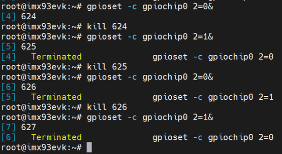

Hi Team,
 I has  checked list of GPIO's in /sys/class
Is this GPIO's is located on J1001 40-pin header on EVK and how to know gpiochip512 is mapped to which pin number. Please guide me to test GPIO's in EVK kit.

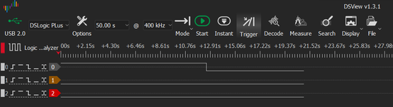

The gpiochip that manages the J1001 GPIOs is gpiochip0.
The GPIO number matches with the number in schematic:
For example, EXP_GPIO_IO02 in pin 3 of J1001 is controlled as next:

Robbi
Thanks @JorgeCas,
can you tell me what is number 625 626 and 627 is it calculated from formula:((port)*32) +((index)&31)).
2,016 Views
JorgeCas
Those numbers are the process number assigned for each command used, it is not related to GPIO number.
Best regards.
