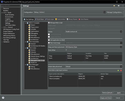

1st project heap and stack:
1st project mcu settings:

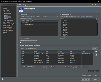

2nd project heap and stack:
2nd project mcu settings:

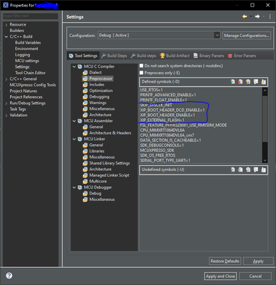

  • To enable the SDRAM, it is necessary to add the XIP_BOOT_HEADER_DCD_ENABLE=1 in the following location C/C++ Build > Settings > Preprocessor, then the ROM code will fetch the DCD to initialize the SDRAM during the boot-up process.

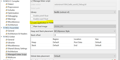

  • It is also require to link the application to RAM I attached an image for reference.

We made the RAM settings as seen in the 1st image.
And we set the necessary preprocessor directives as in the second image.
But when we try to debug, it either freezes or gives errors like in the 3rd image.
