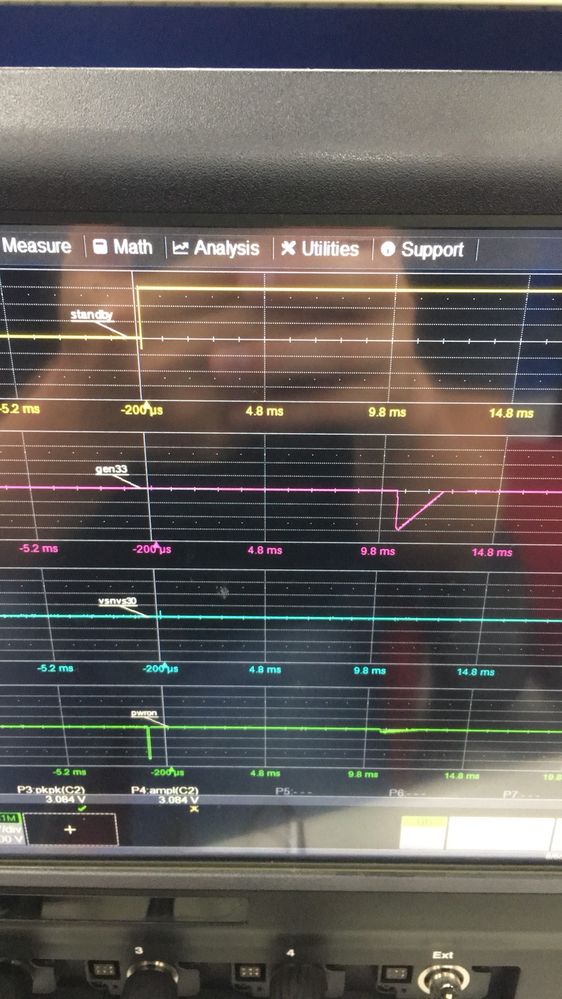

I tried to measure three signals of PMIC Control like below.
  1. STANDBY
  2.  PWRON(connect to WDOG_B )
  3. SW2(gen33 which is EMMC power)
Assuming that main reason why system cannot restart after reboot is because when WDOG_B reset then pwron reset too.
And when pwron reset will cause standby signal high then SW2 will be low-high once.
Because of this cpu cannot recognize Emmc so the machine be handed like picture above.
