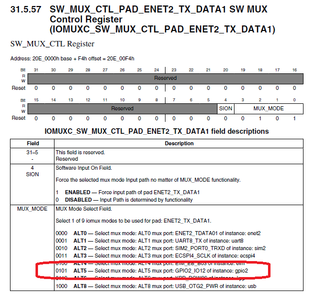

I am trying to build a simple GPIO Toggle Example on the IMX6UL UltraLite Board.
I have had no success yet.
I have created a simple HelloWorld project.
But, I can not expand it to include GPIO Access.
I can Not figure out how to include files such as gpio.h
But all of these fail: <gpio.h>  <Linux/gpio.h>  "Linux/gpio.h"  etc..

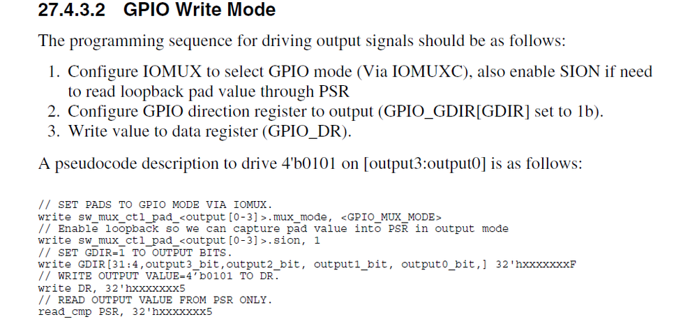

I have also tried direct register access, but just got segment faults:
#include <stdio.h>
int main(int argc, char **argv)
    printf("Hello World!\n");
//printf("\nset MUX\n");
//      *((long*)0x0209C000??) = (5);  // -set MUX
printf("\nset DIR\n");
      *((long*)0x0209C004) = (1 << 23);  // -set GPIO_1_23.Dir = 1
printf("\nset DATA 23\n");
      *((long*)0x0209C000) = (1 << 23);  // -set GPIO_1_23.Dat = 1
    return 0;

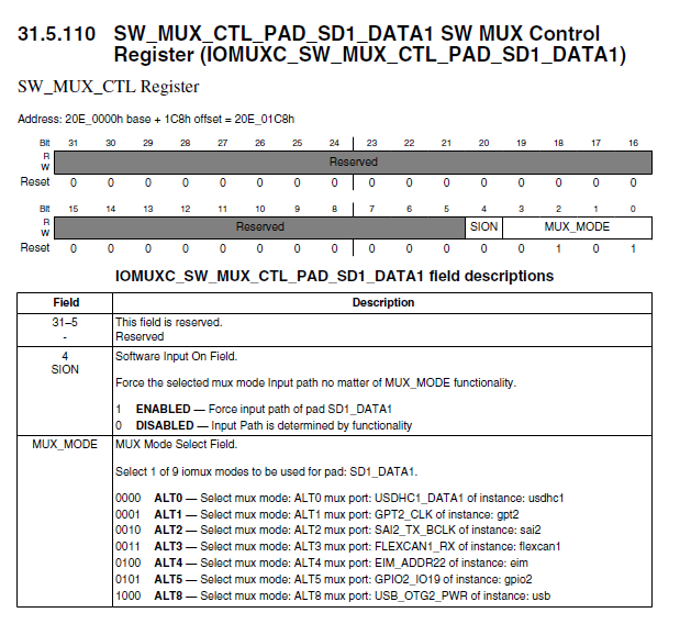

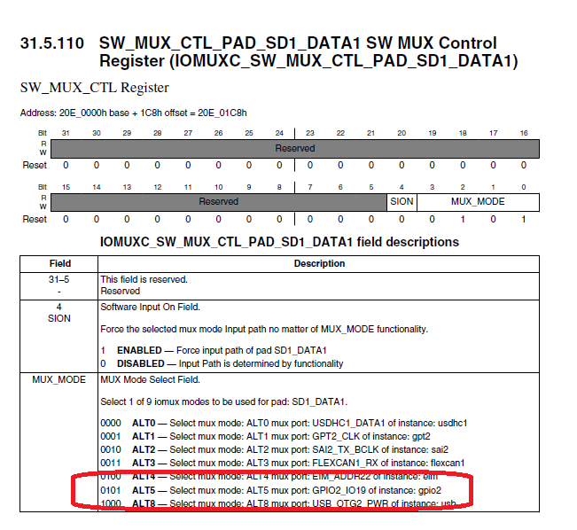

BiyongSUN
Using memtool to set IOMUX as GPIO is just for test.
In the real project, you should modify the device tree.
memtool is very useful debug tool. Not only can configure pad as GPIO but others as well.
Here is example:
root@imx6ulevk:~# /unit_tests/memtool IOMUXC.SW_MUX_CTL_PAD_SD1_DATA1.
SOC: i.MX6UL
IOMUXC   Addr:0x20e0000
  IOMUXC.SW_MUX_CTL_PAD_SD1_DATA1 Addr:0x020E01C8 Value:0x00000000 - SW_MUX_CTL Register
     IOMUXC.SW_MUX_CTL_PAD_SD1_DATA1.MUX_MODE(0..3)     :0x0
             Select 1 of 9 iomux modes to be used for pad: SD1_DATA1.
     IOMUXC.SW_MUX_CTL_PAD_SD1_DATA1.SION(4..4)         :0x0
             Force the selected mux mode Input path no matter of MUX_MODE functionality.
oot@imx6ulevk:~# /unit_tests/memtool IOMUXC.SW_MUX_CTL_PAD_SD1_DATA1.MUX_MODE=5
SOC: i.MX6UL
SOC: i.MX6UL
  IOMUXC.SW_MUX_CTL_PAD_SD1_DATA1 Addr:0x020E01C8 Value:0x00000005 - SW_MUX_CTL Register
     IOMUXC.SW_MUX_CTL_PAD_SD1_DATA1.MUX_MODE(0..3)     :0x5

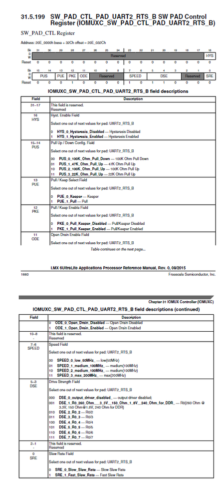

Note sometime you need to set the pad ctrl.
root@imx6ulevk:~# /unit_tests/memtool IOMUXC.SW_PAD_CTL_PAD_SD1_DATA1.
SOC: i.MX6UL
  IOMUXC.SW_PAD_CTL_PAD_SD1_DATA1 Addr:0x020E0454 Value:0x00017059 - SW_PAD_CTL Register
     IOMUXC.SW_PAD_CTL_PAD_SD1_DATA1.SRE(0..0)  :0x1
             Select one out of next values for pad: SD1_DATA1
     IOMUXC.SW_PAD_CTL_PAD_SD1_DATA1.DSE(3..5)  :0x3
     IOMUXC.SW_PAD_CTL_PAD_SD1_DATA1.SPEED(6..7)        :0x1
     IOMUXC.SW_PAD_CTL_PAD_SD1_DATA1.ODE(11..11)        :0x0
     IOMUXC.SW_PAD_CTL_PAD_SD1_DATA1.PKE(12..12)        :0x1
     IOMUXC.SW_PAD_CTL_PAD_SD1_DATA1.PUE(13..13)        :0x1
     IOMUXC.SW_PAD_CTL_PAD_SD1_DATA1.PUS(14..15)        :0x1

Okay Biyong,
I am running the memtool.
I tried following:
# echo 114 > /sys/class/gpio/export
# echo "out" > /sys/class/gpio/gpio114/direction
# echo 1 > /sys/class/gpio/gpio114/value
# ./memtool   IOMUXC.SW_MUX_CTL_PAD_SD1_DATA1.MUX_MODE=5
# ./memtool IOMUXC.SW_PAD_CTL_PAD_SD1_DATA1=0x00017059

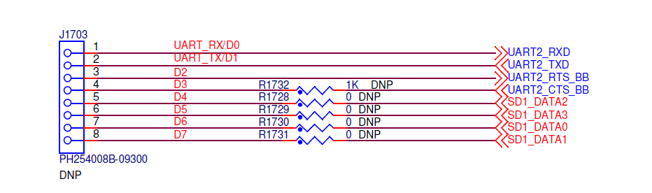

But still the UART2.RXD pin is low, as All pins Voltages on the Board interfaces: J1703, J1704, J1706 (except for the Power pins 3V/5V of course).
-> Notice that cat sys debug - pin114 is still LOW ??
note: I posted earlier, how I disabled interfaces: INET2, UART2, uSDhc1 .

./memtool IOMUXC.SW_PAD_CTL_PAD_ENET2_TX_EN.MUX_MODE=5
./memtool IOMUXC.SW_PAD_CTL_PAD_ENET2_TX_CLK.MUX_MODE=5
./memtool IOMUXC.SW_PAD_CTL_PAD_ENET2_TX_DATA1.MUX_MODE=5
./memtool IOMUXC.SW_PAD_CTL_PAD_ENET2_RX_ER.MUX_MODE=5
./memtool GPIO2.DR=0xffffffff

Even here, the ENET2 pins on the Board are all just 0-volts.
I even disabled ENET PHY in the menuconfig.
Only GPIO19 works.
Maybe a Clock needs be Enabled for the GPIOs ?

and show how to swing IOMUXC.SW_PAD_CTL_PAD_SD1_DATA1 to a HI state on the output Pin ?

In the i.MX6 serials(i.MX6D/Q, i.MX6DL/Sole, i.MX6SX, i.MX6UL), it has bit call SION to set.

It is using the memtool to set the SION.
For add code, need to change the settings in the dts/imx6ul-pinfunc.h
But it just for loop back to linux system. here you can seen in the debugfs. It is not the madantory.
You can use the an oscilloscope or multimeter to confirm that signal.
The debugfs is just for debugging. For software to see the GPIO changes.
In the regular using, the value get/set is in the /sys/class/gpio.
Suggest don't set SION for output in programming.

root@imx6ulevk:~# /unit_tests/memtool IOMUXC.SW_MUX_CTL_PAD_SD1_DATA1.MUX_MODE=5 root@imx6ulevk:~# /unit_tests/memtool IOMUXC.SW_MUX_CTL_PAD_SD1_DATA1.MUX_MODE=5
SOC: i.MX6UL
write 0x00000005 to Bit 0..3 of 0x020E01C8
root@imx6ulevk:~#
root@imx6ulevk:~# /unit_tests/memtool IOMUXC.SW_MUX_CTL_PAD_SD1_DATA1.SION=1
SOC: i.MX6UL
write 0x00000001 to Bit 4..4 of 0x020E01C8
root@imx6ulevk:~#
root@imx6ulevk:~#
root@imx6ulevk:~# echo 51 > /sys/class/gpio/export
root@imx6ulevk:~#
root@imx6ulevk:~# echo out  > /sys/class/gpio/gpio51/direction
root@imx6ulevk:~# cat /sys/kernel/debug/gpio

/unit_tests/memtool IOMUXC.SW_MUX_CTL_PAD_ENET2_TX_DATA1.MUX_M ODE=5
SOC: i.MX6UL
write 0x00000005 to Bit 0..3 of 0x020E00F4
root@imx6ulevk:~# /unit_tests/memtool IOMUXC.SW_MUX_CTL_PAD_ENET2_TX_DATA1.SION= 1
SOC: i.MX6UL
write 0x00000001 to Bit 4..4 of 0x020E00F4
root@imx6ulevk:~#
root@imx6ulevk:~#
root@imx6ulevk:~# echo 44 > /sys/class/gpio/export
root@imx6ulevk:~#
root@imx6ulevk:~# echo out  > /sys/class/gpio/gpio44/direction

BiyongSUN
I have replied at 10:06  pm on 2015-12-20.
The test is for SD1_DATA1 and ENET2_TX_DATA1.
The changes for ENET2_TX_DATA1 are highlight in RED.
Copy and paste again, here
SOC: i.MX6UL
SOC: i.MX6UL

BiyongSUN
I measure from the  R1731 for SD1_DATA1. It does take effect.
11,496 Views
johncoleman
-> I had success with 3 pins, off of the J1703 bus, UART2 RX + TX + RTS.
UART2 / Pins need to be disabled in the imx6ul-14x14-evk.dts file also.

This will toggle Pins 1, 2, and 3 on J1703 bus.
Pin 3 RTS is OpenCollector so it needs a PullUp resistor.

I don't know what is "OpenCollector" here for i.MX6UL RTS. Cause i.MX6 has no OC setting for a PAD. But it has OD setting.
In the IOMUX module, i.MX6 has software pad control, which can change the open drain to others including pull up.
Also you can change it in device tree  or use the memtool to change it for test purpose.
