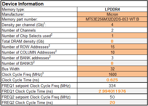

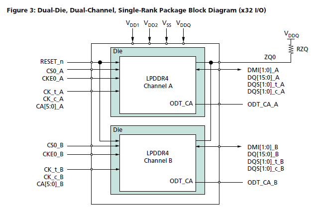

How should we set Shared ZQ resistance in RPA when using LPDDR4 configured as shown below?
We do not share anything except Reset_n and RZQ in our schematics.
In such a case, should Shared ZQ resistor be DISABLED?

I'm sorry the term of 'rank' confuses you. RANK used on DDR is chip select (CS).
"Shared ZQ resistor" can be either enabled or disabled in your configuration because there is only 1-rank (1-CS), but DISABLED is better.

How many RANKs do you use? If you only use one-rank LPDDR4, you can set "Enalbe/DIsable Shared ZQ resistor" to DISABLED. If you use two-rank LPDDR4 but you have two ZQ resistors, you also set it to DIABLED. Otherwise, you should set it to ENABLED

Should the "Shared ZQ resistor" be set to Enable when using the LPDDR4 shown in the figure above with the configuration in the table below?
