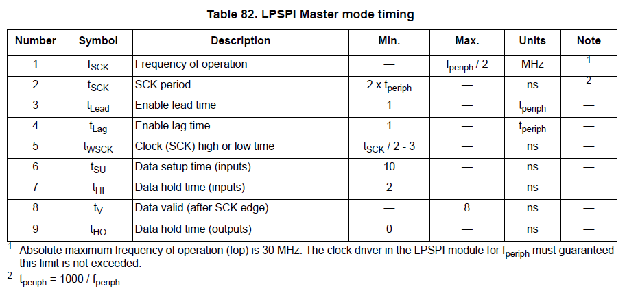

I am trying to find the maximum SCK frequency that is supported by i.MX RT 1170. The datasheet mentions that the max. frequency is fperiph/2 as shown in the figure: Screenshot 2023-11-14 144856.png

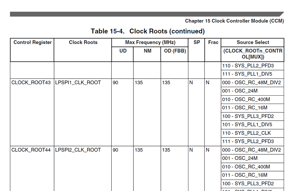

I tried to find fperiph in the reference manual, but I couldn't find it. But I did come across something called LPSPI1_CLK_ROOT. Could someone please explain whether fperiph is the same as LSPI1_CLK_ROOT?

fperiph is LPSPI peripheral clock. I'd recommend you to take a look to the CCM in the Reference Manual.
You can also take a look to this article.
