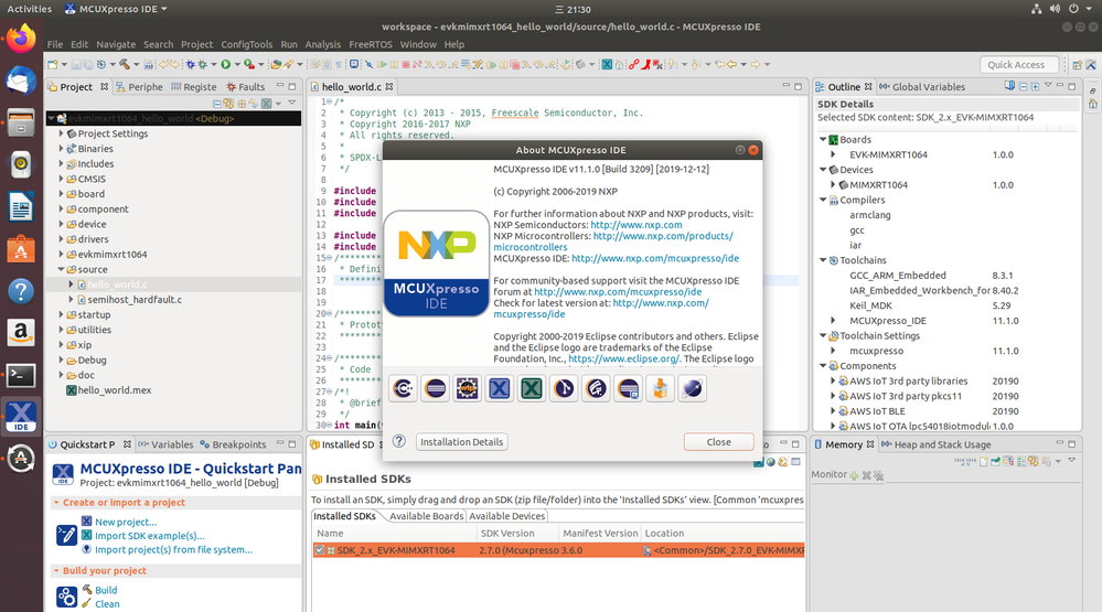

I am running MCUXpresso v11.0.1 on Linux, with SDK_2.X_EVK-MIMXRT1064 installed.
However, none of the newly generated SDKs v2.7.0 can be installed - they all report
"java.lang.Exception: java.io.IOException: Unable to find valid manifest files in SDK".
Removing the SDK I have installed, restarting the IDE and attempting to add the new SDK as the first and only one _also_ fails.
Please fix ASAP !

The problem was that SDK 2.7.0 only works with IDE 11.1.0 and better.

Hi Tamir Michael,
I was wondering if you can share the screenshot of the error message, as I haven't encountered the similar error you described.

This problem is also reported if there are no other SDKs present (the ones that are present are 2.6.x for RT1060 and 1064).

It seems a bit weird, whether you can replicate the phenomenon on other PCs.

A colleague will be installing MCUXpresso as well soon - hopefully I will then be able to provide more information. Thanks.
