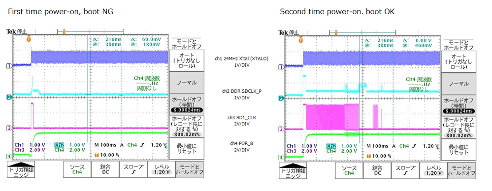

My customer have already built a custom board with i.MX6SL and they have a problem with SD boot.
Some of the board fail first boot but it can boot after second time.
They tried following things.
1.It can boot normally when they turn on the power with pressing the reset button
2.It can boot normally when they press the reset button after boot fail
Form the above, they guess it have some problem with reset and clock timing.
So they check the timing of POR_B and XTAL. (Please see a following picture.)
From the pictures, it seems that is has no problem with the timings.
Then, they checked the SD clock output to confirm the point of where the i.MX is stopped.
As a result, they confirm that the SD clock wasn't output.
From the results of the investigation, we guess that ERR007927 may cause this issue.
Is there a way to confirm that this errata is caused the issue ?
And do you have any idea to avoid this issue ?

  For such issues, with non stable boot, it makes sense
check power up sequence.
  Also, the erratum ERR007927 may take place, so, please
try workarounds for it.
  Another point for consideration - DDR stress test can help
to find possible memory issues, assuming memory initialization
is the same for the test and customer’s applications.

Please see the attachment. It shows power up sequence.
Regarding workaround,  they tried 1 to 3 workaround but there are no affect.
Let me confirm about workaround No.4 and No.5.
Those workaround can only do with adding a reset IC. Is my understanding correct ?
Is there any way to do it with SW change ?

You may try to add a cap to POR - at least just for test.
