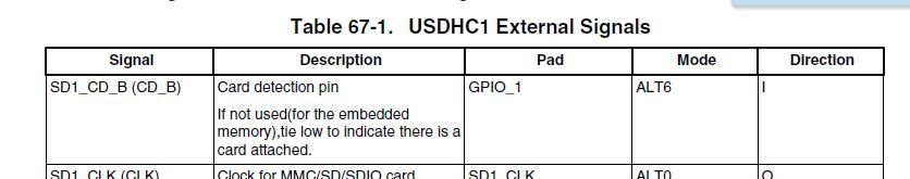

         when i read the SarbreAI souce about SD card, i have a question for iomux setting of USDHC.
         for example, the SD_CD pin connects with GPIO_1 pad in SabreAI.
          According to chip manual , the pad should be set to ALT6
           but in source, it set the GPIO_1 pad to ALT5
           like this:
               //SD1_CD
              MX6Q_PAD_GPIO_1__GPIO_1_1,
         i don't know what the difference between them is.

Hi fang
for CD,WP one can use these dedicated pins and
any GPIOs. Idea is well described in
Chapter 15 Adding Support for the i.MX53 eSDHC
MX53UG MX53SUG.book
