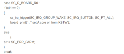

when I use scu to wakeup A core from KS1 mode, it failed.
Here are my steps to suspend and resume the system:
1、Use "echo mem > sys/power/state" to put A core into the KS1 mode

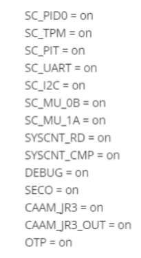

      The following are the resources when the A core is in KS1 mode
2、Wake up A core through SC_R_BOARD_R0
  I made the following modifications to board_set_control in the board.c file in SCFW
when I trigger the wakeup source, I can find this log "set A core on from KS1" in the SCU console log, which means the ss_irq_trigger has been executed. But actually the A core did not wake up.
only the following resources are awakened
Partition: 0 = on
SC_PID0 = on
SC_TPM = on
SC_PIT = on
SC_UART = on
SC_I2C = on
SC_MU_0B = on
SC_MU_1A = on
SYSCNT_RD = on
SYSCNT_CMP = on
DEBUG = on
OTP = on
DB = on
DBLOGIC = on
DRC_0 = on
DRC_1 = on
Partition: 1 = on
CAAM_JR3 = on
CAAM_JR3_OUT = on
Partition: 2 = on
SECO = on
Partition: 3 = on
Partition: 4 = on
M4_1_PID0 = on
M4_1_UART = on
M4_1_MU_1A = on
SPI_0 = on
SPI_2 = on
SPI_3 = on
CAN_0 = on
CAN_1 = on
CAN_2 = on
IRQSTR_M4_1 = on
GPIO_0 = on
GPIO_2 = on
GPIO_4 = on
GPT_3 = on
MU_5B = on
MU_6B = on
MU_7B = on
MU_9B = on
MU_12B = on
BOARD_R0 = on
Partition: 5 = on
Partition: 6 = on
ENET_1 = lp
SMMU = on
OCRAM = on

Please check with customer, how did they enter board_set_control() function in the wakeup process?
2,897 Views
xiuqi_huang
Hi jimmy,
Here's how I get into the board_set_control() function:
1、Divide the SC_R_BOARD_R0 resource to M4 core, which is partition 4
2、In M4 , use the API sc_misc_set_control()
      if(sc_misc_set_control(ipc, SC_R_BOARD_R0, 0, 0) != SC_ERR_NONE){
             PRINTF_I(KERN_ERR "try to wakeup linux partition faile!\r\n");
      } else {
             PRINTF_I(KERN_ERR "try to wakeup linux partition!\r\n");
      After I trigger the wakeup source I can find the log "try to wakeup linux partition"  in the M4 console log. And in the SCU console log, as I posted before, resources in partition 4 have been woke up.

xiuqi_huang
I'm using my own board with ON_OFF_BUTTON , I have those device nodes in my dts, but somehow it was disabled. when I make it okay, my board can resume from the suspend state, so thank you very much!
