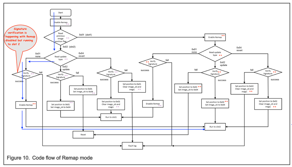

It appears that the Remap flow chart for SBL has some typos and is not the updated one. Can you please provide the correct flow chart?
6,852 Views
pm_2552
Please check the highlighted part in the above flow chart. I have marked all blocks where Remap is enabled with "++" and where Remap is disabled to "--"
The enable Remap block in the above flow should be before verification and that is indeed the case in the SBL code.
6,853 Views
pm_2552

Hello I am using RT1060 and this are the docs I am referring to: AN13460
