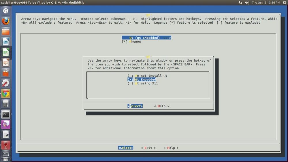

Hi Vishvapathi,
                          we had successfully builded QT on IMX6 board using LTIB. And we are able to run QT applications. You can look into the following steps to build QT using LTIB.
Porting of Qt on i.MX6 board

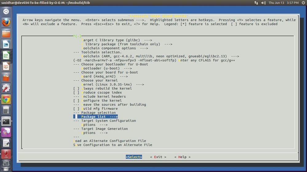

  • cd to your ltib path
  • Type the following command to open ltib config
      $ ./ltib –m config
  • We get the following screen. Select the Packages option
  •   Then select the qt-embedded option
  • Save the changes. Run the ltib by using the following command.
        $ ./ltib
  • This starts building qt-everywhere-opensource package.
