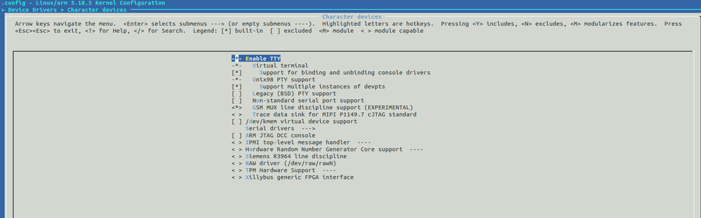

But i'm afraid, I didn't have this options in my kernel config :
I use BitBurner.exe from OTP tools to burn OTP fuses, but I need to read these fuses from linux.
Is there a way to burn fuses directly from linux ? I tried with memtool but it doesn't seem to work.
