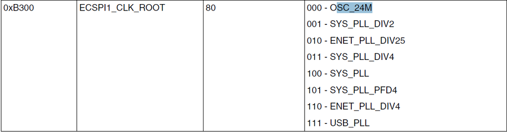

weidong_sun
Hello Jonah Petri,
  The speed of eCSPI moudle on I.MX7D or I.MX7S is up to 80MHz frequency. We can see it In i.mx7s reference manual!
So speed can meet your requirments of your applicaiton.
Weidong

skrap
Hello Weidong,
I understand the ECSPI peripheral can be clocked at that rate, but (see above scope capture) the SDMA does not seem to be able to keep it transmitting consistently at even 16 MHz.
Do you have a comment on that?
Also, see:
https://community.nxp.com/message/869666
