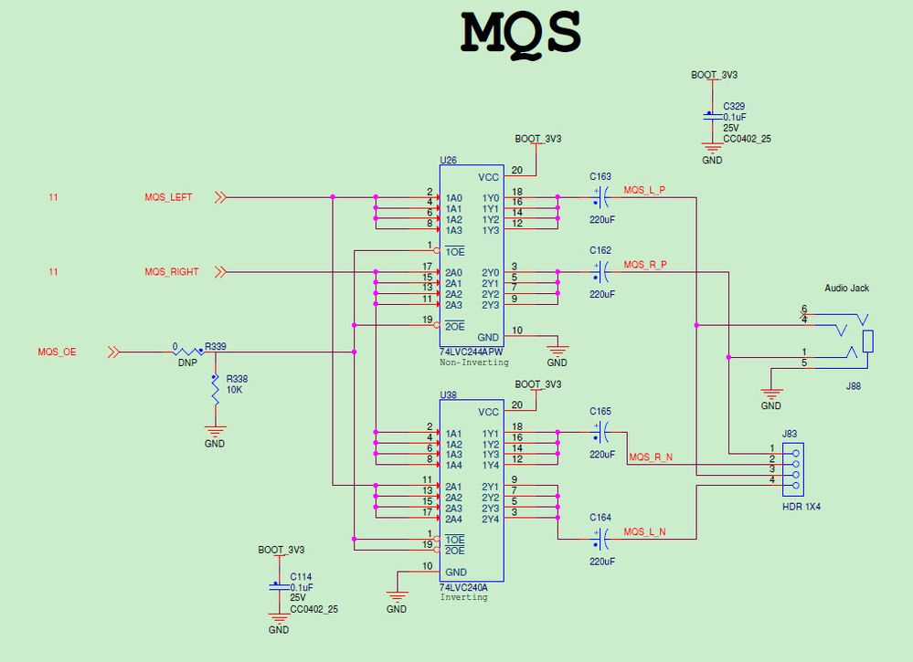

You can use this type driver circuit, then connect to your speaker.
About the sai mqs code, please check the attachment.

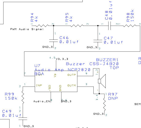

3.
Screen Shot 2021-11-03 at 2.53.53 PM.pngScreen Shot 2021-11-03 at 2.53.53 PM.png
Not using a separate driver.
The above circuit (where pwm Audio Signal is the MQS pin) actually works - and plays sounds, just that we had to mess with the MQS frequency clock dividers to get there. (We also had to change R94/R95 for better volume).
Not sure I understand why you say in your other post that "RT EVK board still can't support the MQS directly" - I suppose this is because the pin isn't directly accessible (not a limitation of the RT device itself, but rather the EVK)?

  My comment that : "RT EVK board still can't support the MQS directly"
  It means, you can't connect the MQS pin directly to the buzzer, you need the driver circuit.
 Eg, this post:
https://community.nxp.com/t5/i-MX-Processors/RT1064-MQS-Driver-Circuitary/m-p/1367103#M182667
Your side also add the amp, it is correct.
