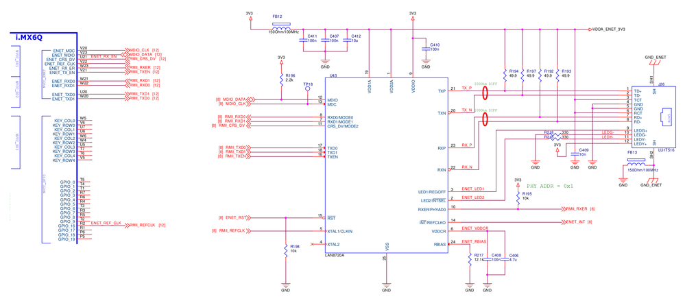

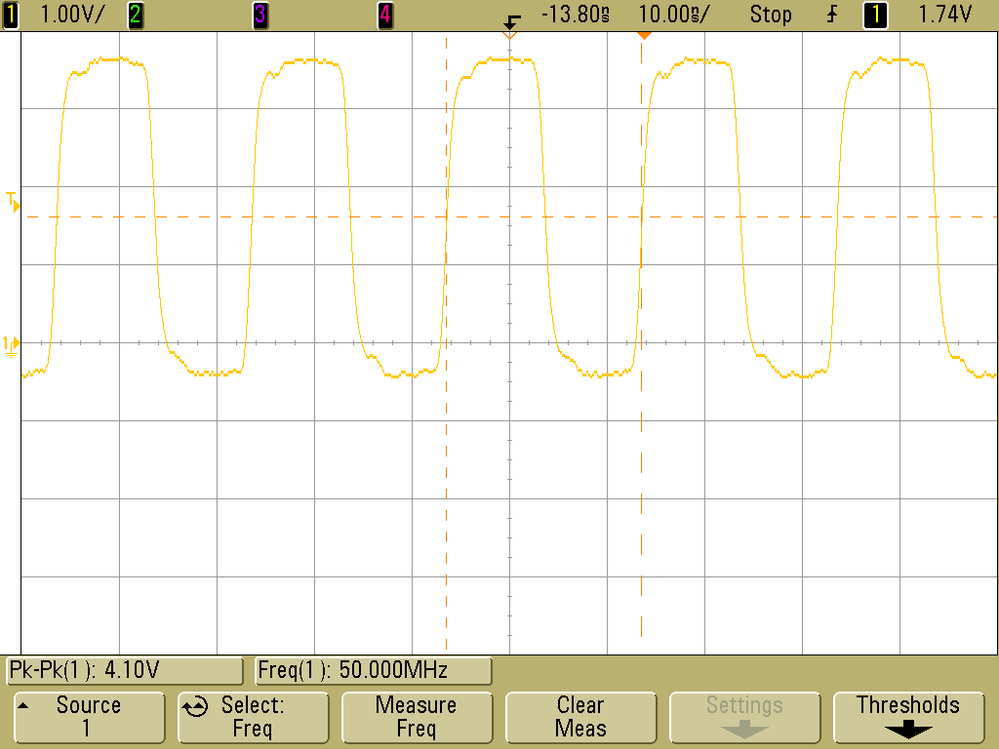

The connection is based on Freescale documentation: IMX6DQ6SDLHDG Rev 1 / Chapter 12.2. The part of schematic is attached. The system uses GPIO_16 pin to generate the reference clock. I measured the clock with frequency counter and is exact (<50ppm). The signal quality is a bit distorted, but is between LAN8720A's timing margins. I tried with different drive strengths, but none of them helped. An oscillogram is attached (in case of DSE=60Ohm). Anyway, I tried with external 50MHz clock on GPIO_16 with ENET_CLK_SEL:0, but same problem.

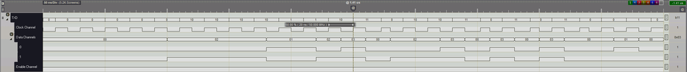

I observed the RMII lines with logic analyzer. It seems good to me, but I can't decode and interpret it.
RMII signals have 1410mils lengths, however REF_CLK has 1750mils.

Finally, I have found the solution.
As can be seen in schematic, ENET_RXD0 is connected to RMII_RXD1, ENET_RXD1 to RMII_RXD0, ENET_TXD0 to RMII_TXD1 and ENET_TXD1 to RMII_TXD0. Ethernet instantly started to work when I fixed these lines.
