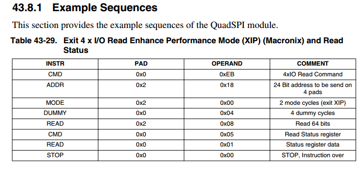

mfgTools provide three files:
qspi-nor-macronix-mx25l51245g-config
qspi-nor-micron-n25q256a-config
qspi-nor-spansion-s25fl128s-config
thoes files are not match my flash (mx6ull + S25FL256S_64K).
how to modify thoes files to fit S25FL256S
thanks

igorpadykov
Hi jianlei
please refer to Table 8-23. QuadSPI Configuration Parameters
i.MX6UL Reference Manual
http://www.nxp.com/docs/en/reference-manual/IMX6ULRM.pdf
igor

jianleijia
Hi igor
thanks a lot.
1. reference IMX6ULLRM.pdf:
   Table 8-23. QuadSPI configuration parameters
   43.5.3.1 Programmable Sequence Engine
   43.8.1 Example Sequences
2. my worked configure file:
0 /*dqs_loopback=0 or 1*/
0 /*hold_delay=0 to 3*/
0 /*hsphs=0 (Half Speed Phase sampling at non-inverted clock) or 1 (sampling at inverted clock)*/
0 /*hsdly=0 (Half Speed Delay one clk delay) or 1 (two clk cycle delay)*/
0 /*device_quad_mode_en=1 to enable sending command to SPI device*/
0 /*device_cmd=command to device for enableing Quad I/O mode*/
0 /*write_cmd_ipcr=hex value to be written to IPCR register for write cmd of device*/
2000000 /*write_enable_ipcr=hex value to be written to IPCR register for write enable of device*/
3 /*cs_hold_time=0 to 0xF*/
3 /*cs_setup_time=0 to 0xF*/
8000000 /*sflash_A1_size=size in byte(hex)*/
0 /*sflash_A2_size=size in byte(hex)*/
8000000 /*sflash_B1_size=size in byte(hex)*/
0 /*sflash_B2_size=size in byte(hex)*/
1 /*sclk_freq=0 to 6*/
0 /*busy_bit_offset=bit position of device BUSY in device status register*/
1 /*sflash_type=1 (Single), 2 (Dual), 4 (Quad mode of operation)*/
0 /*sflash_port=0 or 1 (Port B used)*/
0 /*ddr_mode_enable=0 or 1*/
0 /*dqs_enable=0 or 1*/
0 /*parallel_mode_enable=0 or 1*/
0 /*portA_cs1=0 or 1*/
0 /*portB_cs1=0 or 1*/
0 /*fsphs=0 (Full Speed Phase sampling at non-inverted clock) or 1 (sampling at inverted clock)*/
0 /*fsdly=0 (Full Speed Delay One clk delay) or 1 (two clk cycle delay)*/
0 /*ddrsmp=0 to 7 (sampling point for incoming data in DDR mode)*/
08180403 /*lut[0] command sequence*/
24001c08 /*lut[1] command sequence*/

1000001 /*read_status_ipcr=hex value to be written to IPCR register for reading status reg of device*/
