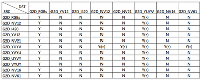

Hello christhi,
RGB888 is not supported for CSC. Supported SRC/DST CSC format can be found in i.MX_Graphics_User's_Guide.pdf:
RGBs format: { (string)RGB16, (string)RGBx, (string)RGBA, (string)BGRA, (string)BGRx, (string)BGR16, (string)ARGB, (string)ABGR, (string)xRGB, (string)xBGR }

quercuspau
From this table, I understand that all the formats from src column can be converted to RGB.
Regarding to RGB888, IMX Graphics user guide mentions:
• RGB pixel buffer only uses planes [0], buffer address is with 16 bytes alignment on i.MX 6 (except i.MX 6Quad Plus), 1 pixel alignment on i.MX 6Quad Plus, i.MX 7ULP and i.MX 8 family devices.
• NV12: Y in planes [0], UV in planes [1], with 64bytes alignment,
• I420: Y in planes [0], U in planes [1], U in planes [2], with 64 bytes alignment
• The cropped region in source surface is specified with left, top, right and bottom parameters.
• RGB stride alignment is 16 bytes on i.MX 6 (except i.MX 6Quad Plus), 1 pixel alignment on i.MX 6Quad Plus, i.MX 7ULP and i.MX 8 family devices, both for source and destination surface.
If I understood correctly, i.MX 6 (except i.MX 6Quad Plus) only support 16/32 bits RGB. However other IMX that uses G2D doesn't have this limitation, only requires pixel alignment that can be 8/16/24/32 bits. In this case, RGB888 should work.
Am I wrong?
