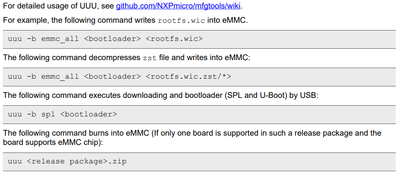

Rita_Wang
For detailed usage of UUU, see github.com/NXPmicro/mfgtools/wiki.

kiyoung
As I wrote in the question, I assembled the image myself.
I used zstd instead of bz2, and it worked well.
The UUU documentation I have (by nxpfrankli) says to use bz2, so I did that.
bz2 does not write compressed files correctly.
zstd works fine.
