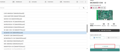

Can you tell me how to download the lower version of SDK as you suggested SDK2.16?
Although, I tried to download it, but I couldn't find any option to change the SDK version from MCUXpresso SDK Dashboard website. Could you guide me to this?
1,666 Views
Zhiming_Liu
You can select version here:
Zhiming

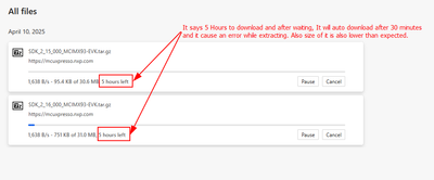

rk4
Thanks for reply.
I couldn't be able to download the SDK version 2.16 or 2.15 as well. Please see the problem in the image.
Now do you have other option to download it OR if you have 2.16 Version of SDK, could you provide me that along with its example directories?
