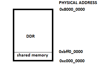

4. ADDRESS OR BAR
Latest question.
My iMX6SX has 1GB DDR.
The start physical address of DDR is 0x8000_0000.
The end physical address of DDR is 0xc000_0000.
If I want a shared memory of 1MB at the end of my DDR, my address is 0xbff0_0000.
writel(0xbff00000, pp->dbi_base + PCI_BASE_ADDRESS_0);
writel(SZ_1M, pp->dbi_base + (1 << 12) + PCI_BASE_ADDRESS_0);
Is it OK ?
