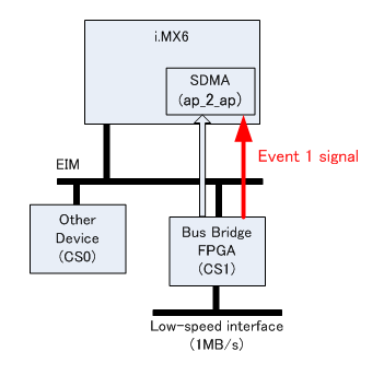

I want to control i.MX6's SDMA  like following.
Two device is connected on EIM.
one FPGA works as a bus bridge between EIM and low-speed interface. It receive bulk data from low-speed interface intermittently.
I want to use SDMA for low-speed interface to reduce CPU workload. But FPGA does not have a FIFO memory. It can receive only 1 byte. So SDMA speed is limited by low-speed interface. I am afraid of bus busy by burst DMA with low-speed interface.
I have three questions.
1. Can I change burst size of SDMA for EIM?
2. Can I use peripheral DMA for EIM devices?
3. Can FPGA control SDMA access by changing a level of SDMA_EXT_EVENT after SDMA is triggerd?

As for Your questions :
1.
> Can I change SDMA burst size for EIM?
For SDMA ROM (mem-to-mem / ap_2_ap) – No.
2.
Basically – yes.
3.
Please use
“imx6 SDMA and EIM bus”
https://community.freescale.com/thread/324491
