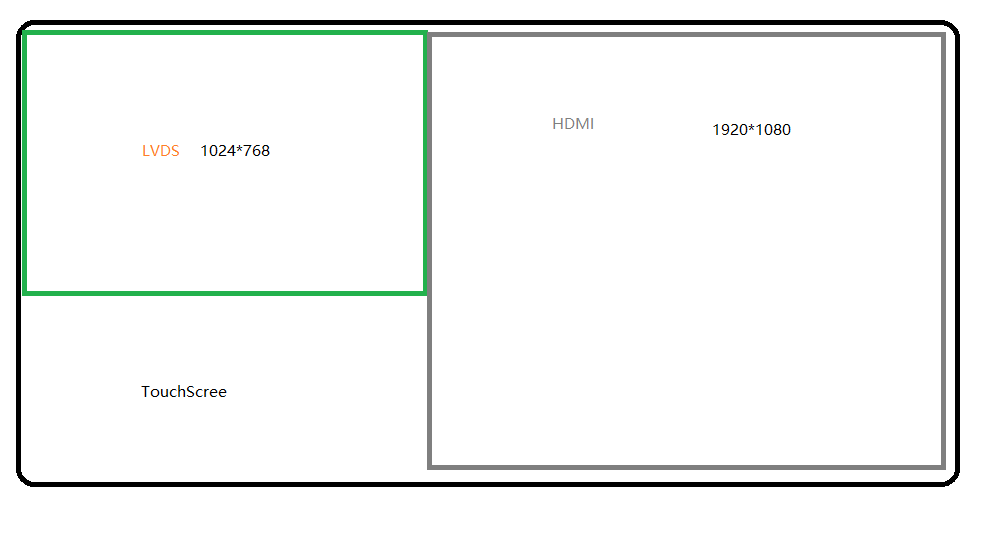

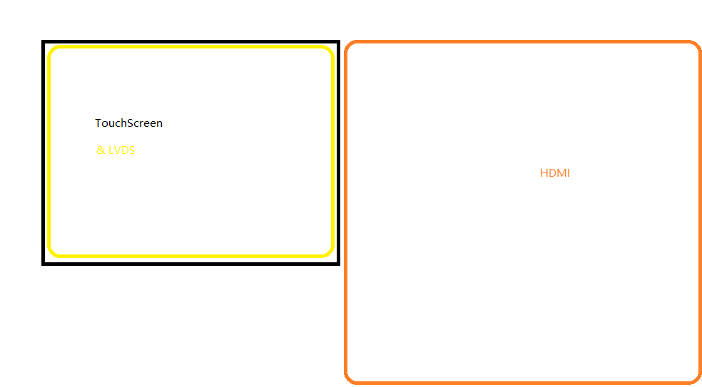

Mihan
Sorry my description is unclear.
Here is my configure file "/etc/X11/xorg.conf".
Now both monitors can be used (hdmi and lvds), but the touchscreen can control the pointer between different display screens.
I want this touchscreen is just matched with lvds, but not affected other input devices.
PS: the touchscreen configuration may be the default.
Maybe these picture can explain what I want
