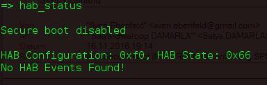

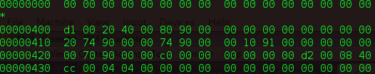

Hello Everyone,
I solved it through a contributor to u-boot, Sven Ebenfeld.
Solution:
Change the DCD address in IVT to 0x0. For the moment I just hacked it using hex editor but this has to be changed in the code. That means my new SPL.imx looks as follows
Output:
Why did it work? Possible Explanation:
DCD is actually information about initialising RAM which I assume is done by the firmware part, the second stage of bootloader (u-boot.img). So, there is no necessity of it being mentioned in the IVT data structure. So, changing DCD address to 0x0 doesn't effect the booting in any way.
Greets & Thanks,
Satya

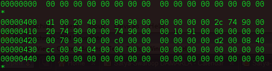

Hello Fabio, Hello Igor
Thanks for the link. I had a look deeply into the link and it has nothing to do with my problem. The patches in the link are for SPL (1st stage bootloader) to authenticate u-boot.img (2nd stage bootloader). On the other hand, my problem is with ROM Boot authenticating the SPL. This is one step before and had to do with the way ROM Boot authenticates the 1st image, i.e. SPL
My SPL.imx is as follows
The HAB error is
It's actually at DCD data. The error means the following
0x33 - failure
0x06 - Invalid Command - command malformed
0xC0 - Error occured while executing CSF or DCD, in our case DCD
0x00 - Any Engine
Data - "CC 00 04 04" which means
CC - Write Data
00 04 - Length of DCD which is 4 Bytes
04 - Width of addresses which is 32bit or 4 Bytes.
Can you guys tell me why this occurs? Is it a mistake that the length of DCD data is only 4 Bytes and the rest is empty? Did  any one check their SPL's DCD data?
