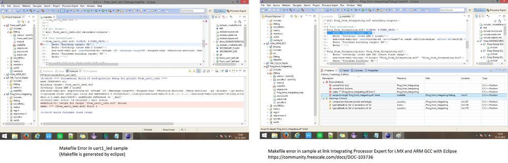

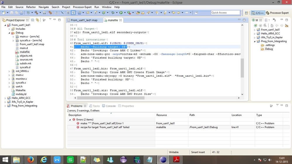

The problem now I face is in the makefile. Please check in the attached .jpeg file which shows an error relating make***[] error 1.
I am using GNU ARM Eclipse Build Tool for make. GNU ARM Eclipse - Browse /Build Tools at SourceForge.net
May I please know where am I going wrong.

sarasur
I deleted makefile of your sample example then build it. Eclipse generated its own makefile. Still I get the same error. Any solution to this problem?
I have followed the steps at Integrating Processor Expert for i.MX and ARM GCC with Eclipse to get eclipse up and running for iMX6DL bare metal LED flicker. I have even build the sample  sources.7z.zip​ at that link but it too gives an error for the makefile (after letting Eclipse to create its own makefile)
I have attached .jpg to show the errors thrown. First image shows Makefile error in uart1_led    and Second image shows Makefile error in sample at Integrating Processor Expert for i.MX and ARM GCC with Eclipse  ( -lcs3 and -lcs3arm error may be due to Sourcery Codebench toolchain used by the author but I have used GCC ARM toolchain GCC ARM Embedded project files : GCC ARM Embedded )
Any solution to this error of makefile???
Sarang

After reading GNU ARM Eclipse / Support requests / #30 Trying to compile with arm-none-eabi-g++    and   Help for building or using GCC , it seems that the error is in the Linker Script (mx6dq.ld file).
But still the mystery of error continues. I am using ARM GCC version 4.9.3
Sarang

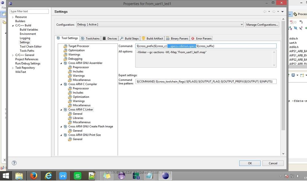

sarasur
Thank you Yuri for your replies.
I figured out the solution to the error: Undefined reference to '_exit'. After reading http://stackoverflow.com/questions/19419782/exit-c-text0x18-undefined-reference-to-exit-when-using-a...  I had to add --specs=nosys.specs command in eclipse as shown in the figure.
Sarang
