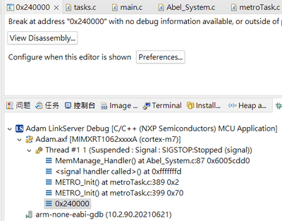

Hi Sir:
The MCU will occurred the MemManage fault after executed a specific program(on web page OTA function during erase flash), this issue wase not happens on the EVM board,below show as register status after fault occurred:
SDK version:
FreeRTOS version: V10.3.0
May I have your recommend for the next step?

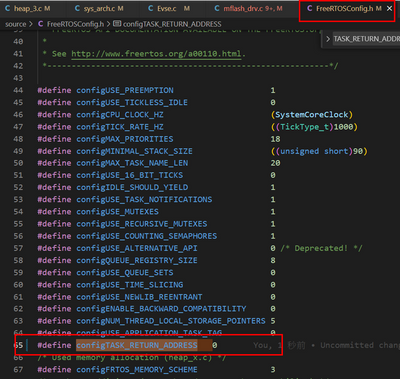

Additionally,  Add the following to the FreeRTOSConfig.h
#define configTASK_RETURN_ADDRESS   0

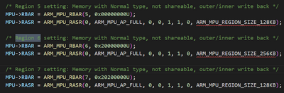

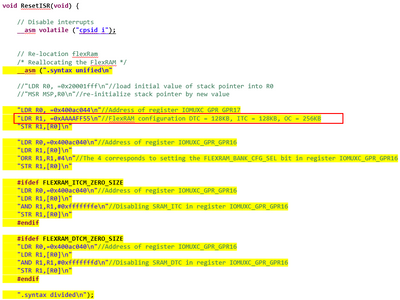

Could you please share with me the memory configuration?
A: Please refer below fig for more details.
 At the moment of crash, to what direction are you trying to access?
A: An  crash occurred before entering the function "mflash_drv_sector_erase_internal". At the moment, input  value sector_addr=0x240000.
A: The constants define has been added on the file. please refer fig below.
