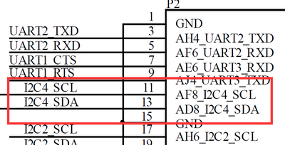

WEI_LIU
The result read by the  i2c tools is: 0xc7
And this is my hardware design:
fxos8700 connected to the i2c4 node of the IMX8MP,  no other pin connections.
And this is my dts configuration:
&i2c4{
    clock-frequency = <100000>;
    pinctrl-names = "default";
    pinctrl-0 = <&pinctrl_i2c4>;
    status = "okay";
