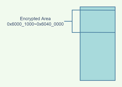

0x60000000..0x60031FFF - Bootloader(XIP image) 200Kb - load and work now
0x60032000..0x60400000 -APP(NON XIP image) 3,8МБ
0x60400000..0x60............ FAT16 file system(which is available by USB device). - 4Мб
The bootloader starts, it creates a usb device with a file system (which is physically located in the flash), various files can be dropped into this device, including an update of APP(NON XIP image). This part work well. Now the question is, where to download the APP(NON XIP image) and then execute it?
I create one encrypt region for the whole flash drive without FATFS part(0x60000000..0x604000000) - this is XIP image(signed with SRK hash)
image_enc ifile=flexspi_nor_edma_transfer_signed.bin ofile=flexspi_nor_edma_transfer_signed_bee_encrypted.bin base_addr=0x60000000 region0_key=0123456789abcdeffedcba9876543210 region0_arg=1,[0x60001000,0x3FF000,0] region0_lock=0 use_zero_key=1 is_boot_image=1
What memory area is my bootloader decrypted to(maybe it FLEXSPI Alias: 0x800_0000..)? is it possible to run it yourself for execution APP(NON XIP image) knowing the address of its execution in flash(0x60032400). How addresses are mapped after bee encrypt XIP image? Or is it possible to execute the flash directly from this address without copying anywhere into memory?
I don't want to create two separate encrypt regions, I only need one with the same SRK HASH(signature) and same AES key.

1) What memory area is my bootloader decrypted to(maybe it FLEXSPI Alias: 0x800_0000..)?
-- The encrypted area starts 0x6000_1000 to 0x6040_0000.
2) Is it possible to run it yourself for execution APP(NON XIP image) knowing the address of its execution in flash(0x60032400).How addresses are mapped after bee encrypt XIP image? Or is it possible to execute the flash directly from this address without copying anywhere into memory?
-- It needs a secondary bootloader to jump to the application which resides 0x60032000~0x60400000, otherwise, it's impossible to run the application directly.
3) Will there be any problems without using LPC 4322?
-- No, it's okay to do it.
