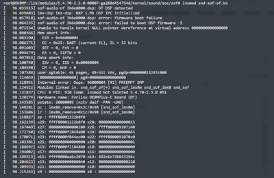

Hello, Everyone. i bought imx8mp dev board(not official version) and success run sof.
the default sof version:
Firmware info: version 1:5:0-cc5ba
kernel version: 5.4.70-2.3.0.
and i wanna to build the same sof version by myself.
at first i build xtensa-imx8m-elf by build tool
the i clone sof and `git reset --hard cc5ba`
of course, i build successful and get `sof-imx8m.ri`
i replace into board  but hang on kernel.
It seem this is a wrong firmware so that dsp cannot load.
which step i do wrong, pls tell me , thanks.

Hello lenghonglin,
I guess you have to build with extensa toolchain but this work on L5.10.72 BSP.
https://www.nxp.com/docs/en/user-guide/IMX_DSP_USERS_GUIDE.pdf
