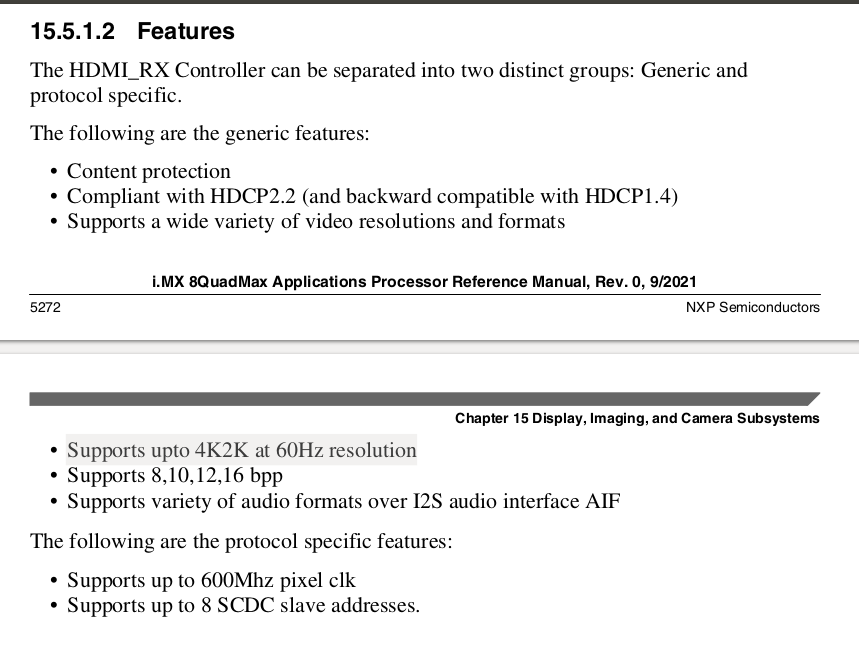

Hi NXP Teams,
I saw following sharing about enabling HDMI Rx in iMX8QM platform :
https://community.nxp.com/t5/i-MX-Processors-Knowledge-Base/i-mx8qm-HDMI-RX/ta-p/1111058
https://community.nxp.com/t5/i-MX-Processors-Knowledge-Base/iMX8QM-How-to-enable-the-HDMI-RX-on-L5-1...
I have a use-case to read 4K HDMI camera input and I would like to know if this could be supported by the aforementioned platform, please ?
Thanks in advance and best regards,
Khang

current bsp can support 4k@30

Hi again,
I read from the RM of iMX8QM that HDMI Rx can support 4K2K 60Hz :
But I am not sure what is the current status of BSP.
Dear @joanxie ,
As author of one of previous sharing about the subject, would you have any additional information to provide, please ?
Khang.

Thanks @joanxie for the confirmation!
