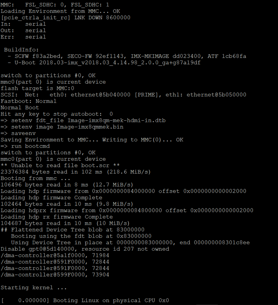

currently, not all of device can be used as hdmi-in for imx8qm, try to use laptop as hdmi in source, connect laptop with imx8qm J1 port and connect J6 port with HDMI display, when the board boot up, don't forget set fdt_file and image as your own image name, then you can find the log file like this:

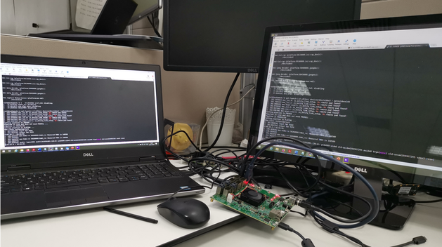

gst-launch-1.0 v4l2src device=/dev/video4 ! autovideosink
then one can see the hdmi display shows the same desktop as your laptop's

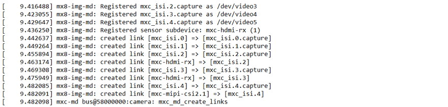

Use uuu to download the uboot and kernel you built, one can use attached uuu script, don’t forget set imx8qm-mek-hdmi-rx.dts when the board boot up, then enjoy it
refer to the logfile as below, we can confirm that /dev/vide3 is HDMI RX device :

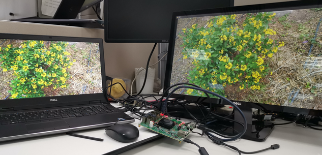

gst-launch-1.0 v4l2src device=/dev/video3 ! autovideosink
we got:
playback one video on the laptop:
