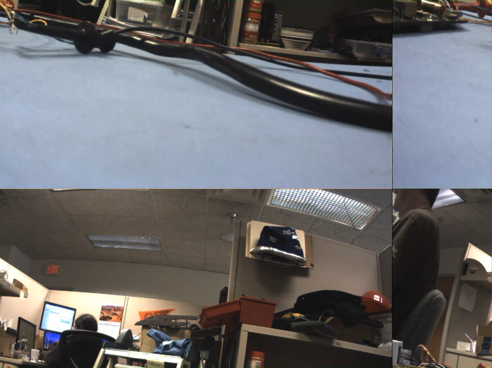

We are currently receiving progressive frames from a MachX02 via MIPI CSI2 on the i.MX6Q, but have so far been unable to solve one final issue. Similar to what is described in section 5 of the IPU TVIN app-note, our stream sometimes starts out-of-sync:
It is important to note that the stream "sticks" with this offset until we completely stop and restart the entire capture stream. It seems that the only time we get correctly synchronized frames is when the MIPI receiver begins receiving before our FPGA begin sending data. If our V4L2 sub-dev driver takes too long to return from ioctl_s_parm() then we end up with some amount of offset as above. Similarly, if something interrupts the stream, such as experimentally restarting the MIPI data stream from the FPGA without restarting the MIPI receiver, we end up with out-of-sync frames.
Our FPGA logic is producing frame-start/frame-end packets, but not line-start/line-end. When frames are not synchronized, we occasionally receive NFB4EOF errors but not on every frame. Most recently we tried to implement the patch provided in the TVIN app-note, even extending it to stop and restart our FPGA's output. Previously we also implemented frame-numbers in the frame-start packets. This appeared to improve the issue, 1 out of 10 starts fail down from 9 out of 10, but did not completely resolve the issue.
Does any one have any comments on why the IPU's FSU is not locking on to the next frame-start/vsync-edge?

We ran out of time to solve the issue: We managed to find a kind of hokey-pokey dance that appears to work 99% of the time by sending 2 (or perhaps 3?) zero-length frames to wake up and synchronize the MIPI receiver. This doesn't help if a line gets corrupted/lost later in the stream, and the end customer has still been experiencing failures (~1% of the time) to start capture at a very low frequency which is frustrating to diagnose.
The only way to absolutely solve this problem, according to section 5.1.3 of the linked app-note is to insert or find a unique line of data in the active video stream, and restart capture if it is not where it belongs. Unfortunately we ran out of development time before we were able to implement this. In theory it should work in our case, as we control the FPGA design that is transmitting to the IMX6, but in other cases such as directly connected image sensors there may not be a way to uniquely identify frame alignment.
