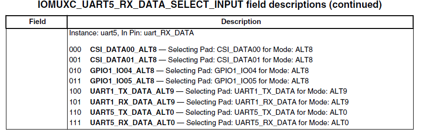

I think I find the reason.In the imx6ul-pinfun.c define the pin of uart5:
#define MX6UL_PAD_UART5_RX_DATA__UART5_DCE_RX 0x00C0 0x034C 0x0644 0x0 0x5
But the input_val is for imx6ul as follow:
imx6ull's input_val is changed:
So I think the right value as below:
#define MX6ULL_PAD_UART5_RX_DATA__UART5_DCE_RX 0x00C0 0x034C 0x0644 0x0 0x7
5,530件の閲覧回数

zhichaohuang
yeah,I have tested.It's working on my board.:smileyhappy:
