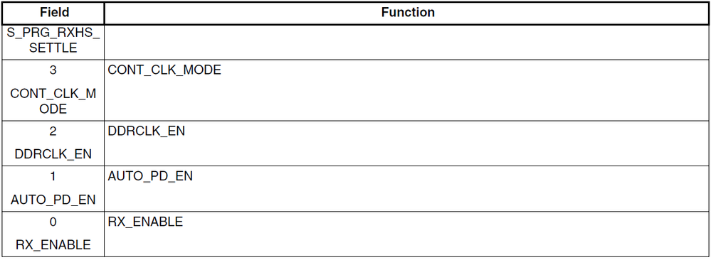

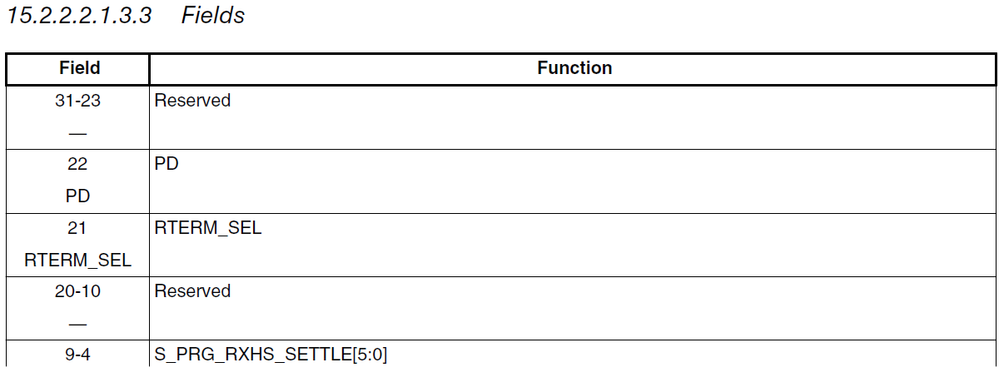

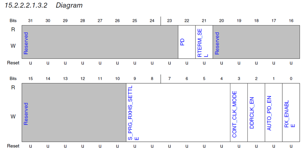

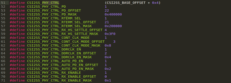

we don't have such document for every bits description, as I mentioned, customer can refer to the current bsp source code, define these bits the same value as linux driver defines.
I already consulted local expert team, they don't have such information either, and they don't think customer should care about this, they suggest customer set as bsp shows
