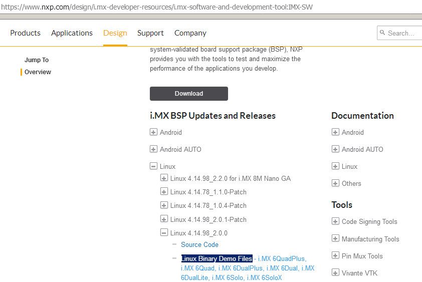

igorpadykov
If you are using NXP Sabre SD board one can try Demo Images
on below link, they work fine with camera.
i.MX Software | NXP
Test steps are described in sect.6.4.2 Video4Linux API test attached Linux Manual.

zhiyuan_song
hi,igorpadykov.
I don't have a display device, how do I get to try Demo Images.
In the i.x Software | NXP link,What am I supposed to do.
thank you very much.
