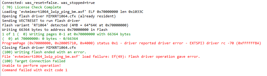

Running example program 'evkmimxrt1064_lwip_ping_freertos' on MIMXRT1064-EVK eval board causes flash write failure (see attached). How do I enable the internal flash area on the 1064?

I'm able to program the i.MX RT1064 via the GUI flash tool as the Fig 1 illustrates.
I'd like to suggest you clean or import the project again before clicking the GUI flash tool icon, in addition, confirm the boot mode is the default which boots from the internal QSPI flash.

I verified that SW7-3 is on (all others off), downloaded a fresh copy of MCUXpresso IDE v10.2.1 [Build 795] [2018-07-25], created a new workspace, imported a fresh copy of the project, checked for updates, built the example in release mode, and attempted to flash; flash failed:
I'm currently running Rev. A hardware, not sure if that's a factor ( 700-32221 Rev A, SCH-32221 Rev A).

Thanks very much! I obtained another evaluation board and this one is working. Thank you very much for your assistance!
