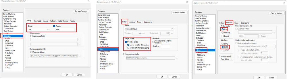

Lukaz
Thank you, it worked fine with me using I-JET debugger.
Just some points to clarify the solution. I have not disconnected any jumper from the board, I have connected J1 3-4 to use the USB-OTG port for power. The important thing was the debugger configurations (see screenshots below)image.png
